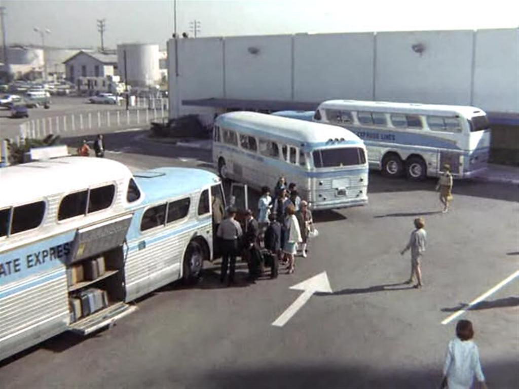

Here is an example
 Filesize:  120.78 KB
 Viewed:  51732 Time(s)

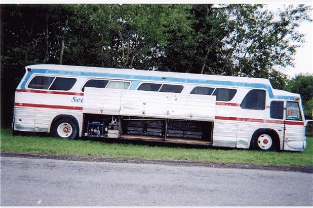

here is a scenicruiser
 Filesize:  76.97 KB
 Viewed:  51730 Time(s)

This is an old GM with the old style doors that was typical of all buses before the Buffalo bus
