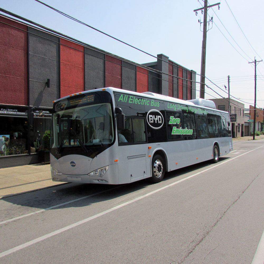

BYD demonstrator in Louisville. Nice-driving bus, but at the time their bus had not passed Altoona testing and they could not assure "Buy America" compliance.
